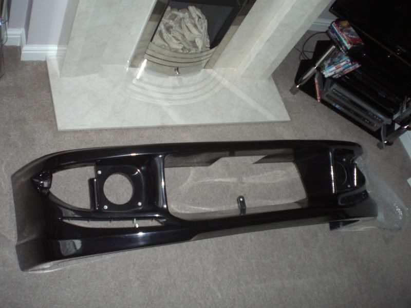

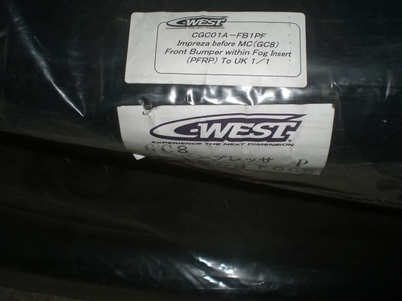

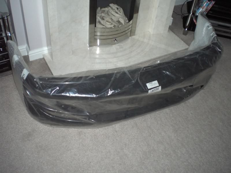

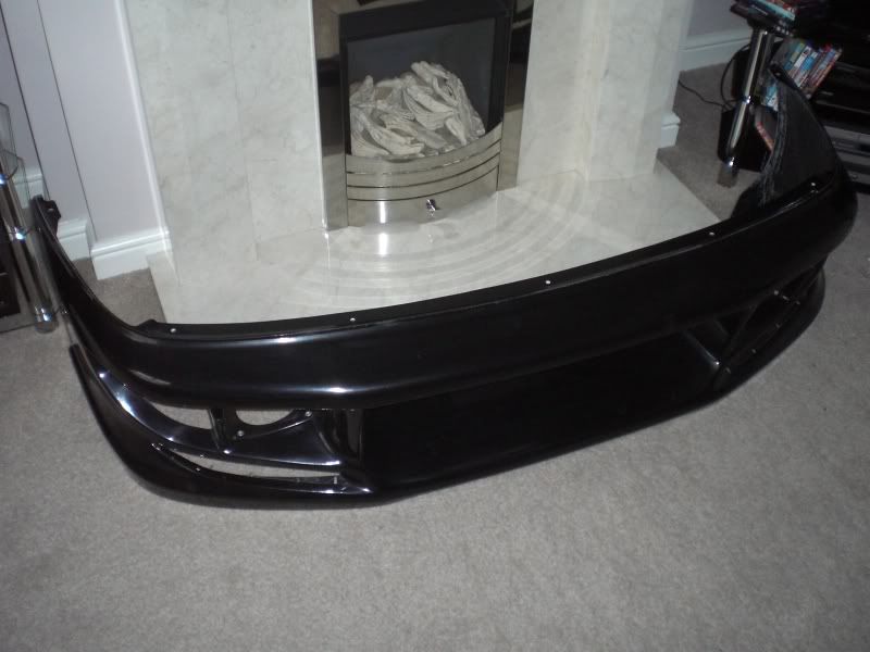

C-West bumper
[Image: CIMG0082.jpg]
[Image: CIMG0083.jpg]
[Image: CIMG0084.jpg]
[Image: CIMG0085.jpg]

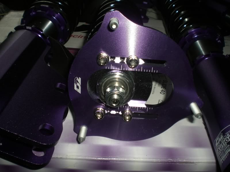

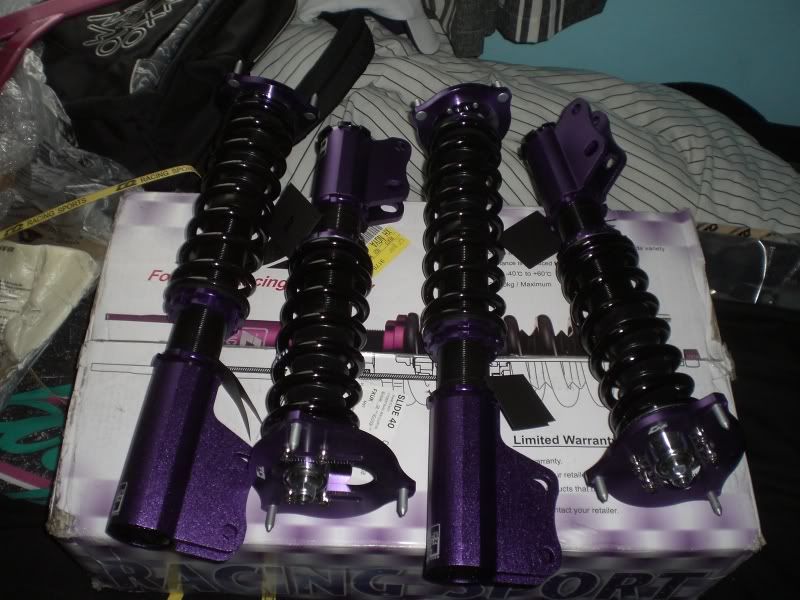

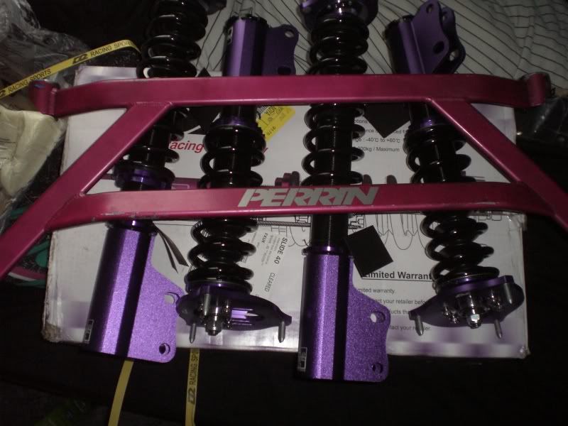

And D2 coilovers, heard mixed things about D2 so thought I'd give them a try.
[Image: CIMG0086.jpg]
[Image: CIMG0087.jpg]
[Image: CIMG0088.jpg]

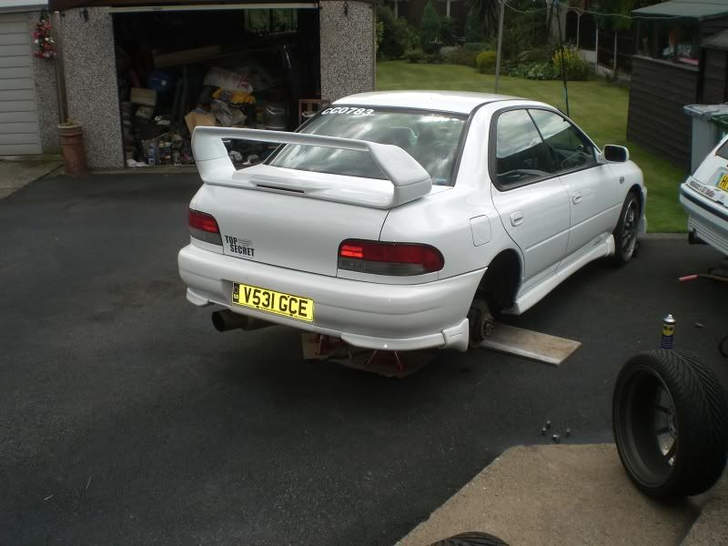

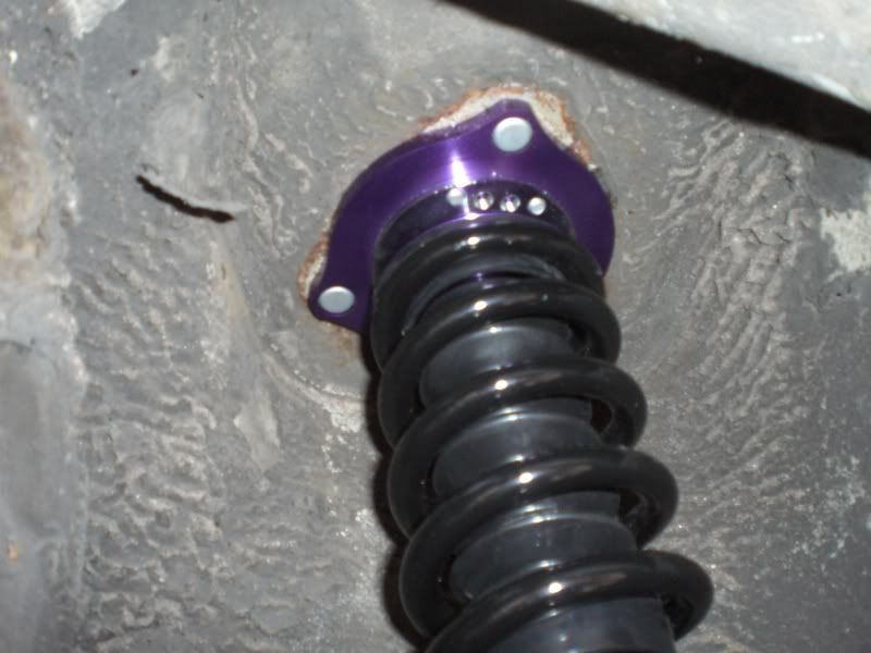

14-07-2008, 09:59 AM (This post was last modified: 14-07-2008 10:00 AM by Saint AAI.)
Post: #59
RE: *Member* Shane's Impreza Turbo 2000AWD

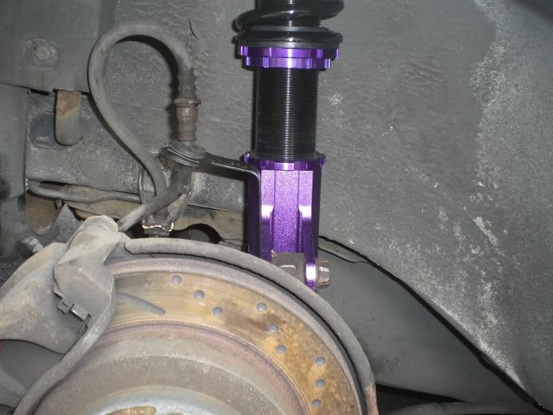

Well, got off my arse and made a start on the coilovers yesterday when I finished work. Only 2 bolts and 3 nuts holding each strut in place so easy job.......or so I thought. 4 and a half hours later I had one rear coilover fitted. Pics up tomorrow sometime, but the problems I had were with the bolts in the bottom being seized up. Covered them in WD40 and hammered the crap out of them for well over an hour before I finally got them out, rounded one of the heads off too, so that slowed me down. Also the brake hose goes through a hole in the original strut and is held in place by a clip. This clip was not wanting to budge so took about an hour to shift. Then I had to undo the brake hose from the caliper to pull in back through the hole then re-connect it so brakes are gonna need bleeding when I've finished. Coilover went in, in about 5 mins, had pre-set ride height etc before it went on so had to make a few changes as it was set to low and I couldn't get the wheel back on under the arch. Sits nicely now so will keep it as is for the time being, but if I get no rubbing I'll drop it a little more. Air wrench is being bought today before I tackle the others, this should make short work of those seized up bolts.
Was getting stressed with it yesterday, but its got me motivated to get working on my cars again so any spare time I get will be spent on sorting them.
15-07-2008, 11:07 PM (This post was last modified: 29-08-2010 08:30 AM by Saint AAI.)
Post: #60
Heres some pics, as with all pics in this thread, click to enlarge:
Up on axle stands:
[Image: CIMG0001.jpg]

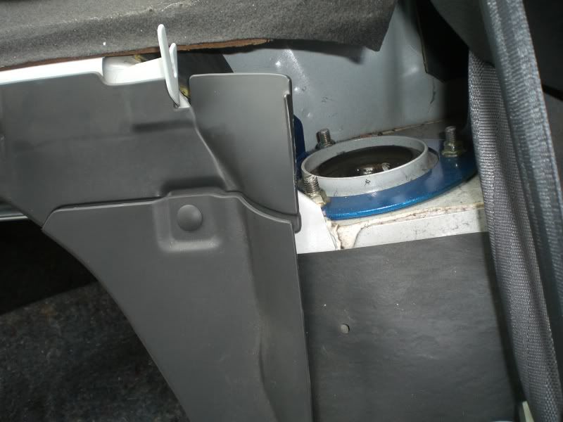

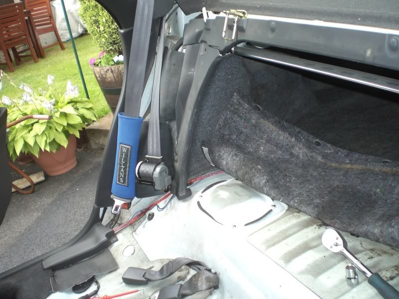

Rear seats and seatbelt mechanism removed to allow access to strut tops:
[Image: CIMG0003.jpg]
[Image: CIMG0004.jpg]
Original suspension with bolts covered in WD40:
[Image: CIMG0002.jpg]
New and old side by side, notice how much shorter the D2's are:
[Image: CIMG0005-1.jpg]
And the new coilover in place:
[Image: CIMG0010.jpg]
[Image: CIMG0009.jpg]

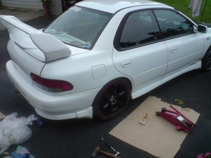

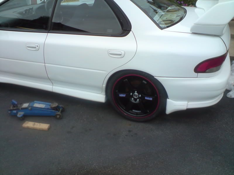

How it sits now, can go lower I think, but going to see how it drives first to see if there is any rubbing:
[Image: DSC00123.jpg]
[Image: DSC00126.jpg]
Air Impact wrench should be here by the end of the week so rest should be on over the weekend.
