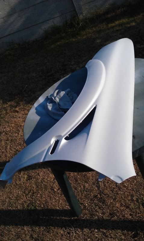

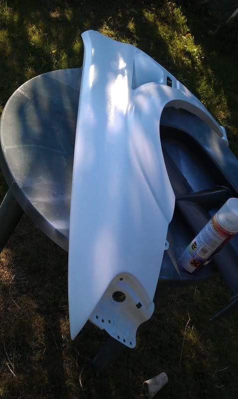

Rubbed one wing down, another coat of primer, then gave it a few coats of paint and another rub down. Couple more coats tomorrow and another rub down and its ready for the top coat. So far I'm happy with it.
[Image: IMAG0357.jpg]

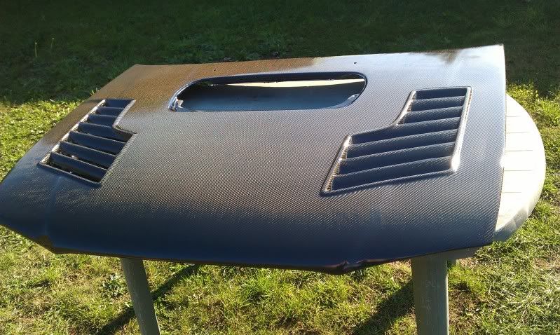

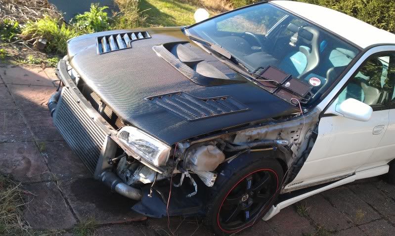

Did another rub down and coat of paint to one wing, then another rub down and a couple of coats of clear coat. Also whilst doing that I thought I'd take a look at my bonnet as the lacquer is going all funny. Took the bonnet off:
[Image: IMAG0423.jpg]
[Image: IMAG0424.jpg]

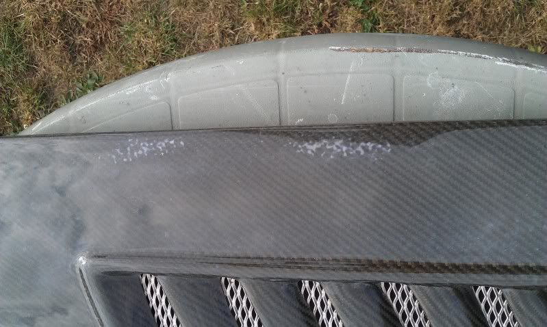

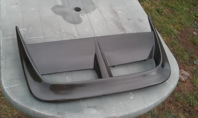

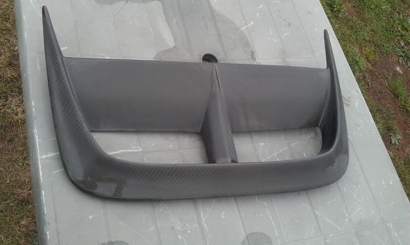

Stripped it down taking the vent off and the mesh, gave it a going over with some wet and dry to remove marks and clouding. Pic of center vent once rubbed down:
[Image: IMAG0425.jpg]

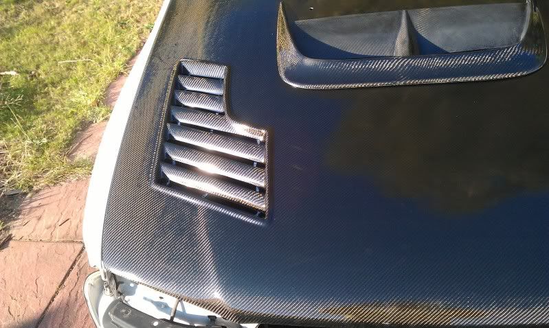

Did a little more other week, couple of coats of lacquer to the wing:
[Image: IMAG0428.jpg]
And also started the bonnet:
[Image: IMAG0429.jpg]

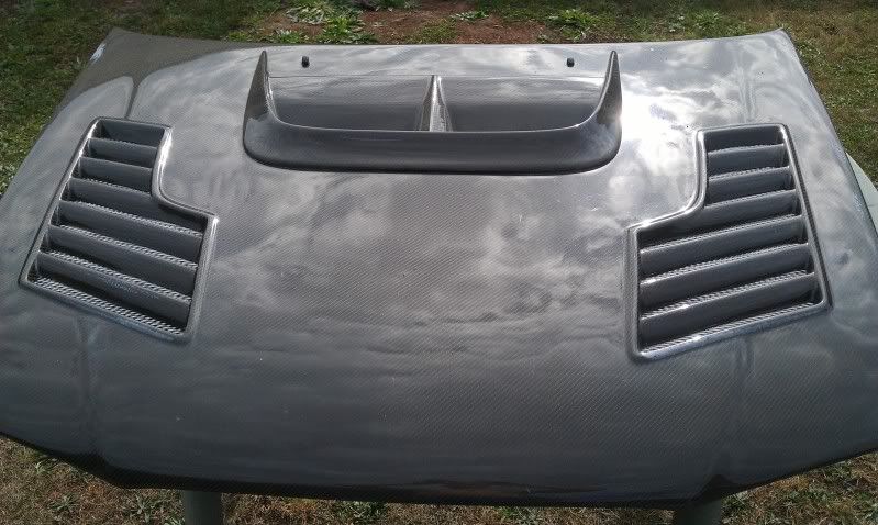

Keep giving it a rub down with bits I'm not happy with and redoing, but ran out of lacquer. Have some more paint and lacquer now so will be able to finish bonnet and other wing. Couple more pics of where I'm at:
[Image: IMAG0431.jpg]
[Image: IMAG0430.jpg]
Will give the center vent a couple more coats and another on the bonnet, then should be ready for final rub down with different grades of wet and dry. That's the bit I'm not looking forward to as it will take ages to get a nice smooth finish I think. Got plenty of different grades right up to a 2500, will finish off with a machine polish.
