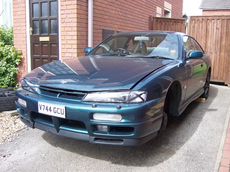

Firstly Todays Task was to Fit My APex Performance Type1 Front Mounted Intercooler
The standard one is pants and small and wing mounted as you can see in the pics, so the increased size and cooling should alow me to run that touch more boost without melting things and gaining more power from cooler inlet temperatures

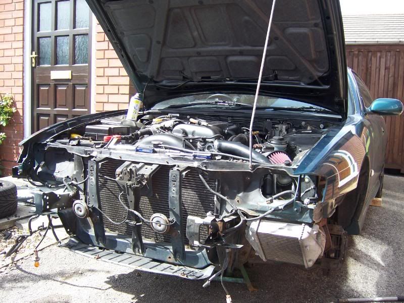

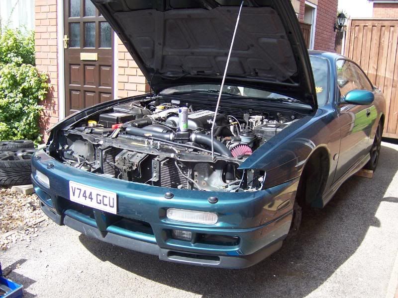

So first thing this morning i removed the Headlights, Grill, Sidelights and Old Intercooler Hot/Cold Pipework..
[Image: 100_0520.jpg]
[Image: 100_0523.jpg]

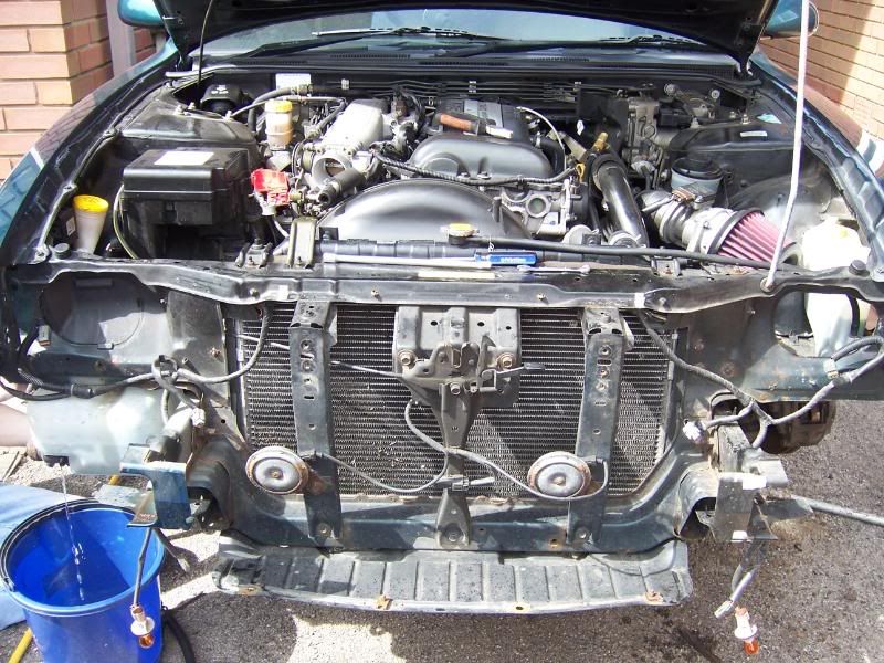

Then Screech and Mike arrived to give me a dig and we cracked on removing the old Intercooler and Front Bumper
[Image: 100_0525.jpg]
Washer Bottle had to be removed and modified so that can be seen draining on the left...

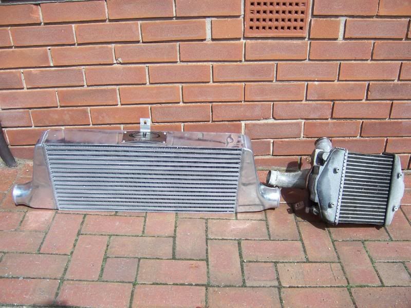

With the old Cooler off, you can see the difference in size and quality should make a great differance to the car
[Image: 100_0528.jpg]
Old is on the right in case you were wondering!

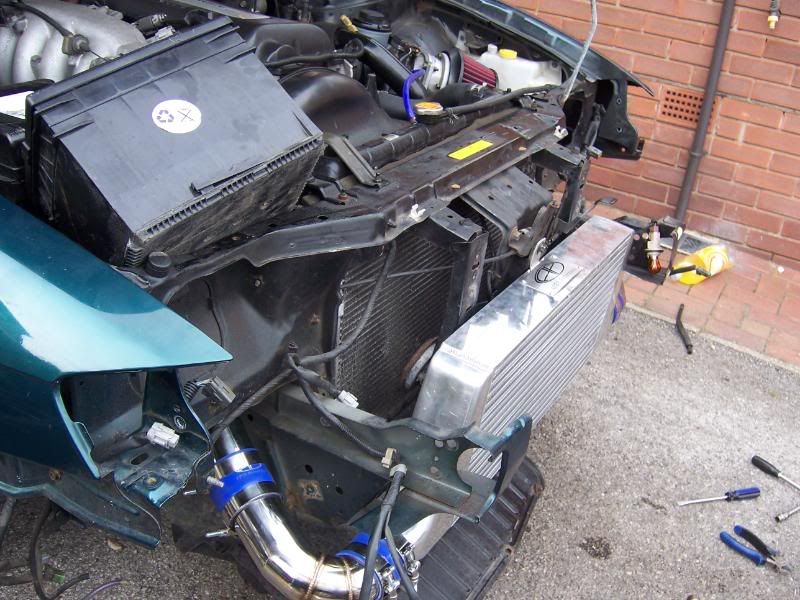

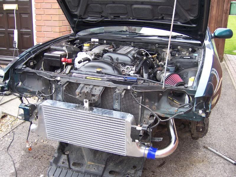

Offerend up the New FMIC with a bit of pissing around and lets say persuding it to fit using the Angle Grinder and attatched the Hot side of pipe work
[Image: 100_0530.jpg]
[Image: 100_0533.jpg]

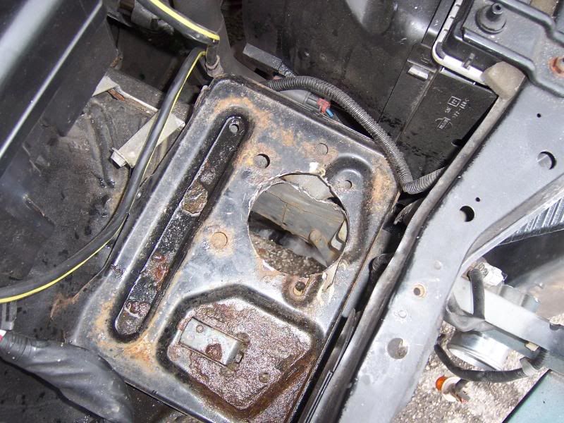

Hole had to be cut in the battery tray for the cold pipework and that was more of a task than we thought!
[Image: 100_0534.jpg]
Piped up the New Cold side and refited the lights tidied up and took her for a shake down run
