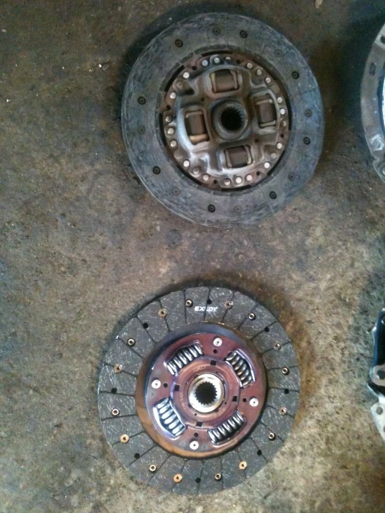

78k on the clock that means in t sport terms its clutch time, this one was mullered so off to Neil at Turner Auto services who stuck a fab exert clutch in for me
