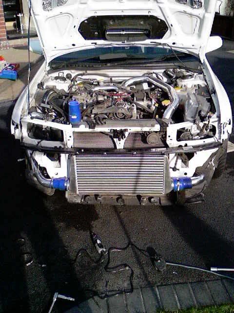

31-01-2011, 05:51 PM (This post was last modified: 31-01-2011 05:55 PM by Saint AAI.)
Post: #116
RE: *MAXXD* Pyro's Subaru Impreza Bugeye
Bumper sits on a cross beam thing with a load of bolts through it. Headlamp out job on a classic, not sure on a bug. Couple of bolts on the sides too. I think it will be fine just clipped at the sides.
Black bar that I've bolted my intercooler to. Probably similar setup on yours.
[Image: Almostdone.jpg]
31-01-2011, 09:49 PM
Post: #117
Yeah, not far off, just a bigger bumper bar:
[Image: IMG_0677.jpg]
