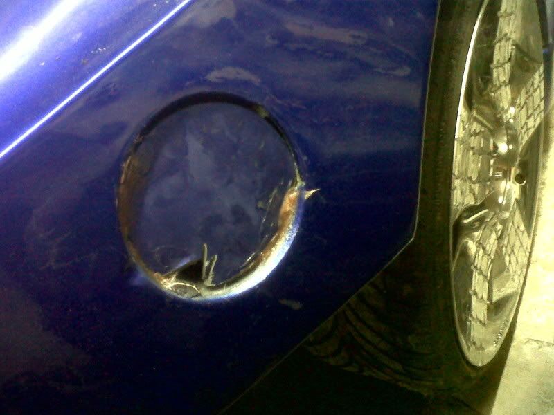

The black hole as it was

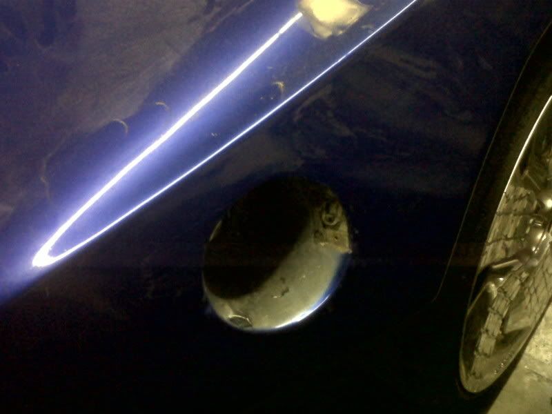

I cut down and used the flap as a base, sitting about 10 to 12 mm lower than the bodywork.

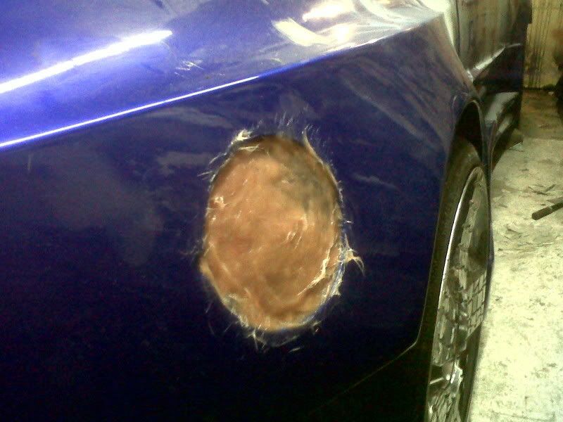

Then filled the gap using fibreglass for strength
[Image: cap03.jpg]

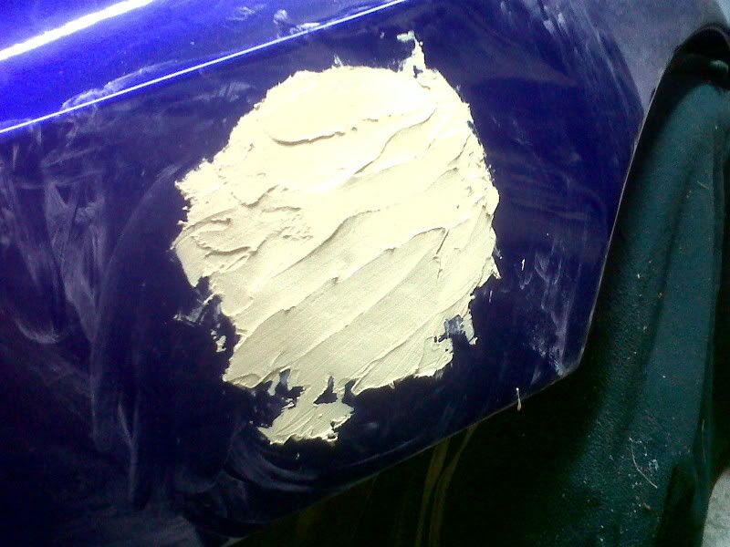

Onec dry I ground away any bits that were too high then covered the lot with filler.

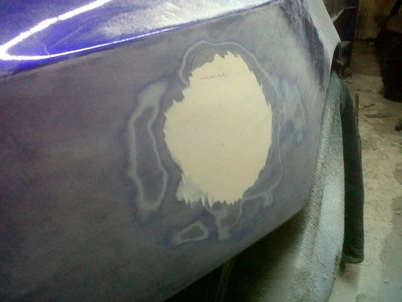

Sanded back using a block to get the level, filled any low bits and sanded again

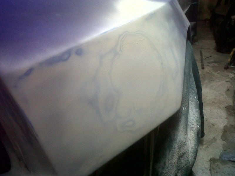

Then covered with a bit of primer. Although it was shite primer, ret thin and ran like bitch.
