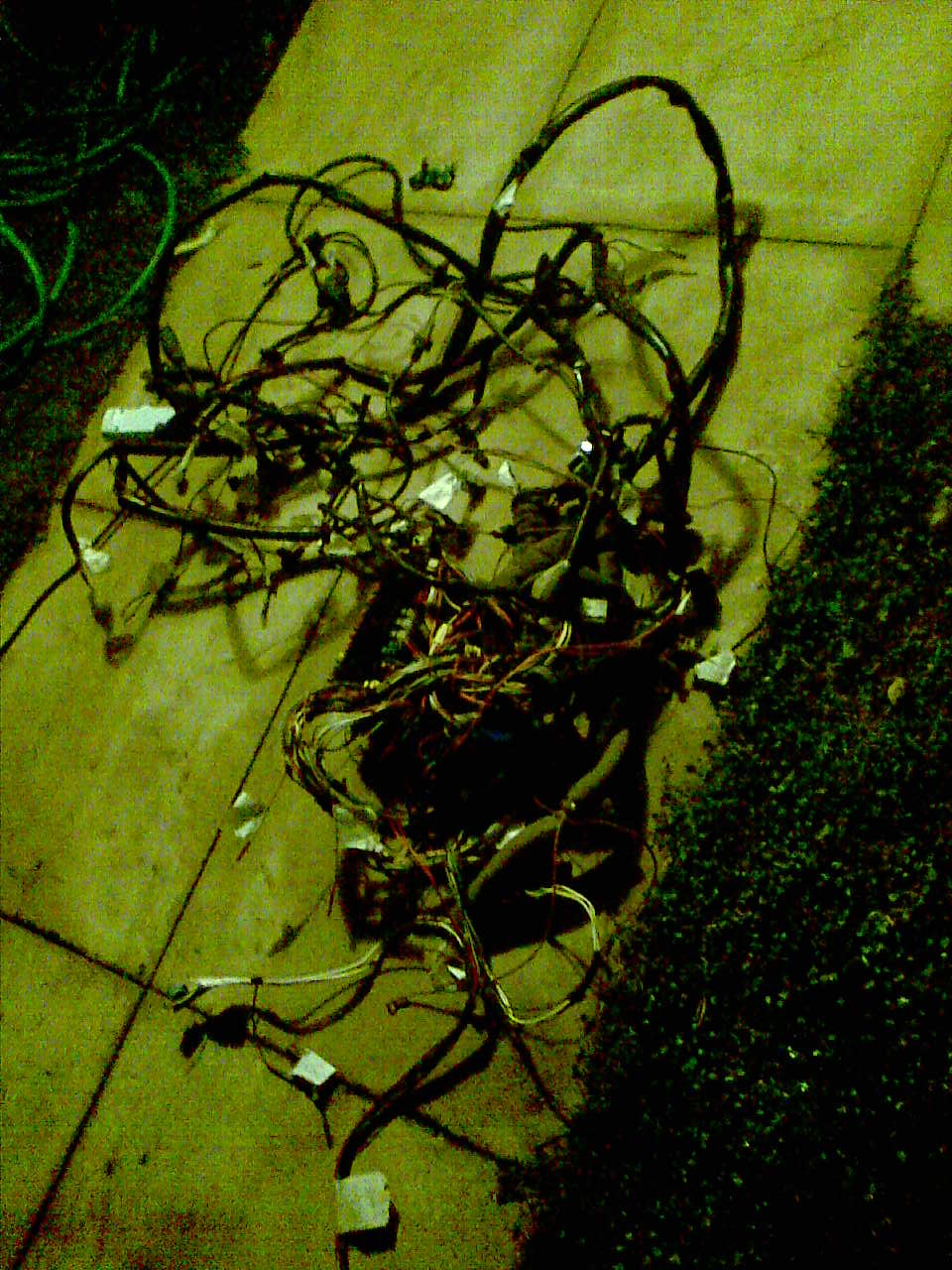

Anyway, newth decided it would be a good idea to lable up and remove all the wiring from the pickup, instead of figure out where the stray wires went (there were a LOT of stry wires!!)
what we found was that there was two wiring looms lobbed together!
whats basically happened, is the guy who had it before me has put a mk2 golf engine in it, but instead of removing the old mk1 wiring loom and making the mk2 one run everything, he las left the old wiring in and left that running the lights etc, and there is another loom just for the engine!
so we have started stripping the looms, removing anything that isnt labled up, and then making one loom out of two Icon_smile

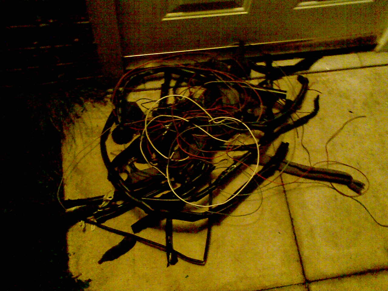

pile of wires removed! two wiring looms
initial shit removed like the heatshrink/wrap from the looms and stray wires

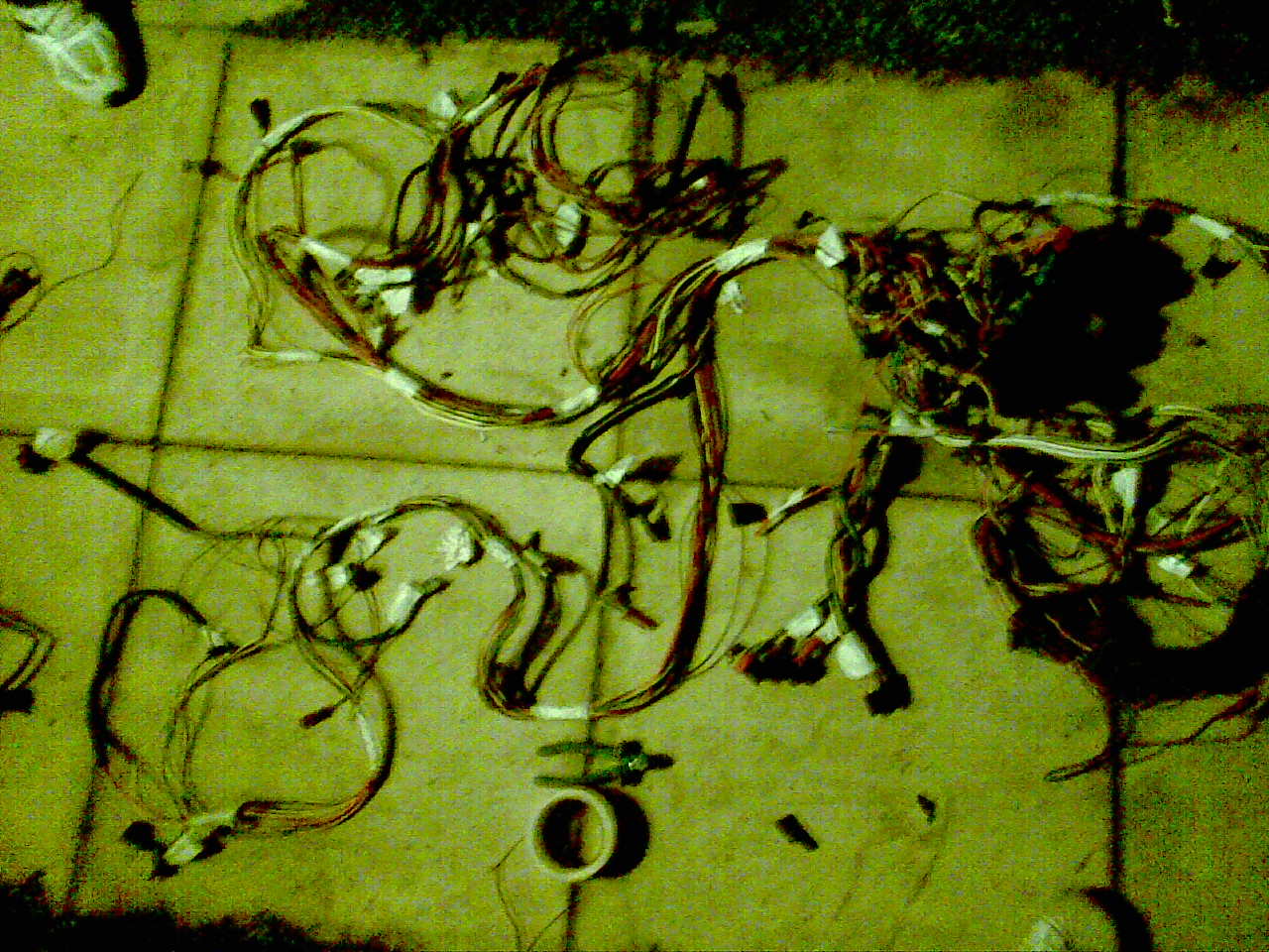

the two looms stripped and labled, now we need to remove anything else stray and fit back into the car, making sure we do a good job of runnning the cables so it doesnt look a mess!
